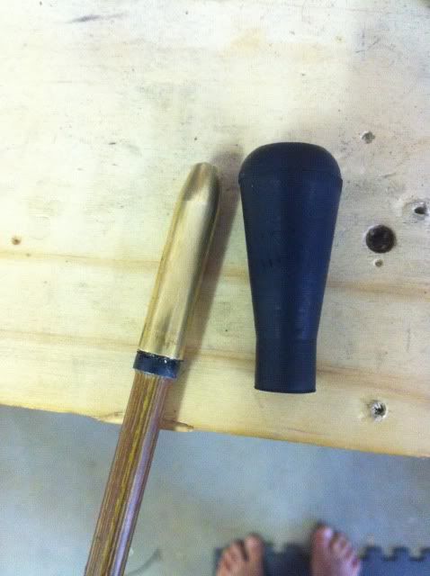

                  I take an empty cartridge casing of any .38 calibers, such as 9mm., .380, .357 mag. or .38 special and glue this over my untapered shaft with hot melt. Once cool, I slide on the blunt. Rubber and plastic blunt weights vary considerably. By weight checking my 11/32” blunts with various cartridge cases, I can find a close match to my broadhead weight of 200 grains.
                  I believe he was also grinding down the rim of the cartridge. I’m not sure if this will work to get you to 300 grains, but it’s worth a shot. (Yes, the pun was intended!) The new issue will be online for Premium Members on Thursday morning. 😀

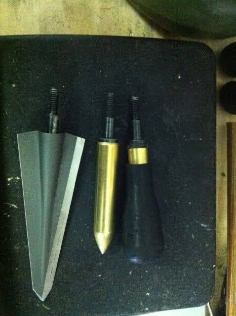

                                    That looks like a serious head handi! I also came up with a 300 grain blunt, that’s perhaps a little less elegant 😉
                                    I couldn’t find anyone who sold 180-200grain glue on blunts, which is what would be required for the rubber blunt solution I had above. So I took a hack saw to a 190grain brass field point I had:
                                    I nipped the tip off with the saw then filed briefly for a weight match. Added a 125 grain steel insert and 120 grain rubber blunt to complete the set.. all these heads weigh the same:
                                    I’m not certain on pricing but it would be somewhere between 3-5 bucks and 5-10 minutes for the 300grain rubber blunt (which is 100% untested for structural integrity…).
                                    EDIT: I thought untested was pretty useless so went and fired a dozen shots into my backyard target (~9 yards) and a few shots drilling into the dirt within 5 yards. That rubber blunt is doing fine.
