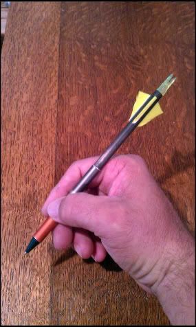

          Post count: 159
          ….but the structural integrity is quite amazing no matter what I write on.:D
          sapcut
            Post count: 159
            Hey…that’s my footed pen feathers!
