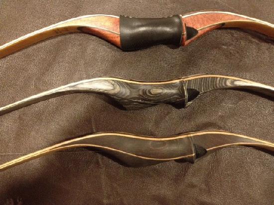

                    A little history on this bow. I started out making self and all wood laminates. Decided to try to reproduce the Willcox Duoflex in all wood laminate in the late 90’s. Made 1-2 dozen of them.
                    This bow is a glass version off the same form. Worked pretty well.
                    Thanks for all the nice comments.
