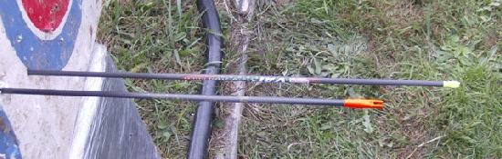

These things really do penetrate though:
After this we put some space between the targets and it seemed to help.

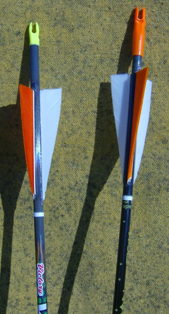

On a side note: I stood on the deck while my son shot… you really can’t hear the fletch of these arrows ! You can see in the photos that these have a slight helical ( didn’t have straight clamps – I kept them as straight as possible and still get good contact between fletch and shaft, but it didn’t seem to matter much on these short fletch). I went with 2.5″ 3 fletch ( not much room on these thin shafts for 4 fletch) with the hope it would be enough to stabilize the broadheads. In retrospect, I think I could have went with 2″… there were no stability issues whatsoever. Broadheads grouped right with field points which grouped with bare shafts.

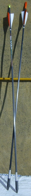

The 630 shaft came in at 392grs. and 29.5% FOC . The 700 shaft came in at only 360 grs. ,but 33% FOC. Neither of them hit the 400 – 425 grs. I was hoping for, and the 630 didn’t quite make UEFOC 😥 . However, both fly like absolute darts:D . My son even commented that these bare shafts fly better than his 3D arrows.
We chronograph-ed both arrows and he’s getting 168 fps out of the 630 and 174 (if I remember correctly… we chrono-ed all of them) out of the 700’s.

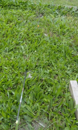

in reply to: AMAZING!!!!Thank You Mr. Ashby! #12282Both arrows passed thru the 11.5″ of styrofoam target and 2″ of ethafoam like it wasn’t even there! The “whump” we heard was the second arrow burying itself into the wood frame we have at the base of our target area. The penetration we were seeing was nothing short of amazing! I’ve shot both these targets before with conventional arrows in the 400-500gr. range out of a 59# bow and have NEVER got penetration like this. ( I should mention that my arrow flight was likely not near as perfect as his either). We kept walking back a fes yds at a time with the same results.
Finally, at 30 yds, the arrows stopped in the target. The 630 was the deeper one, penetrating the whole 11.5″ of styrofoam and 2″ of ethafoam with the point and outsert sticking out the back. The 700 penetrated the styrofoam and just the tip of the field point stuck in the ethafoam.

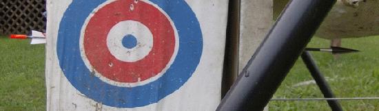

in reply to: AMAZING!!!!Thank You Mr. Ashby! #12274I should mention… we shot thru paper from 10 yds. to 40″ away from the face of the paper. We had to keep moving closer because there just was no discernible difference in the tears! The above photo shows what we found when the paper was 40″ in front of his arrow. The 570 showed a slight wag to it (so we eliminated it), but the 630 and 700 look dandy!
I should mention at this point the problems we had with “containing” these little beasties. That first shot on the left went through 11.5″ of virgin styrofoam, 2″ of ethafoam, and 13″ of a multi-layer Cabelas foam target. The arrow finally stopped when it hit the 2nd to last layer of very dense, hard foam in the rear of the target. I should also mention that none of these targets are “shot out” (the ethafoam has been shot very little actually) and we purposely positioned the targets so he would hit away from the center and into virgin or less shot areas of the targets. Honestly, pulling arrows was a pain.
After seeing the tears with 630 and 700 arrows we walked back to 20 yds. We had the styrofoam set up with the 2″ ethafoam immediately in back of it. My son let loose with the 700 and all I saw was a slight flash of yellow (nock) and I heard the slight “thuk” of it hitting the styrofoam. I told him to shoot the 630… I heard “thuk” “WHUMP” ! What the heck ? We walked up to see this:
