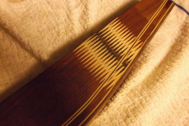

                        It’s pretty, Troy. Real pretty. Are the riser accents inlays or overlays?

                          Those aren’t inlays or overlays, pierce points run angled thur the riser. It’s kinda like a finger joint on both sides of the dark piece. I finger jointed the hickory and the walnut. Glued them together, then fingered jointed the walnut on the other side and the next piece of hickory. After all the joints are glued together the block has to be big enough to turn on an angle and resquare the block again. It’s kind of hard to see, but if you look at the off side of the riser you will see the points on the lower end. then they run angled thru the riser and out of the sight window side on the upper end.

                                Ben,
                                Hopefully this comes out right. Having alittle problem with the pics.
                                Anyway, this should give you a better idea of how the pierce points look in block form. Even though these are what I call my shockwave they are built the same way just a different bit in the jointer.
                                As you can see the points are on the left bottom.

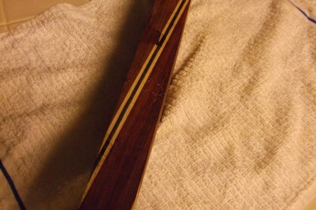

                                Now they are coming up thru the block.

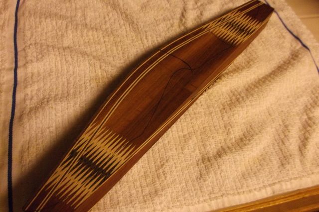

                                Then they come out on the right top.

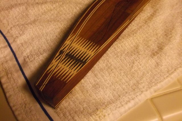

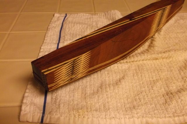

                                                    Now I’m going to really blow your mind. I’ll show you the whole riser block with the Shockwave.
                                                    As you can see, there is more to that riser block than just the one Shockwave. In fact it really has three.

                                                      I see it! I see it! God help me it took awhile, but I see it now. Man, what a piece of work. That there is downright complicated. It’s the foresight that’s required to produce such beautiful art that makes it truly amazing.
                                                      Well done!
                                                        Think I’m going to make that riser into my next project.
                                                        I need another three piece longbow.:D

                                                                      Troy, Where is this one as a finished bow? I would love to see pics of it!!!
                                                                      Jans
                                                                        Jans,
                                                                        The riser block is still sitting in the bow room. Built so many bows last year and earlier this year I’m kind of burnt out on building. Besides I’ve got so many furniture build projects going right now. I wouldn’t have time to work on another bow. Been working on a couple of rocking chairs for Christmas presents. Good thing I started on them really early in the year. Never would have thought it would take months to make something that looks so simple.
