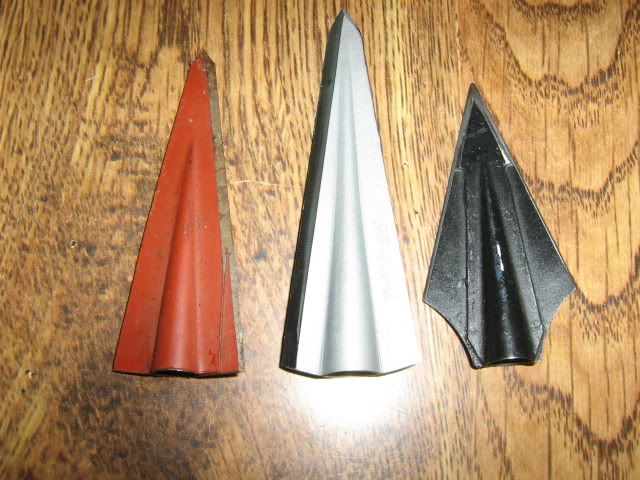

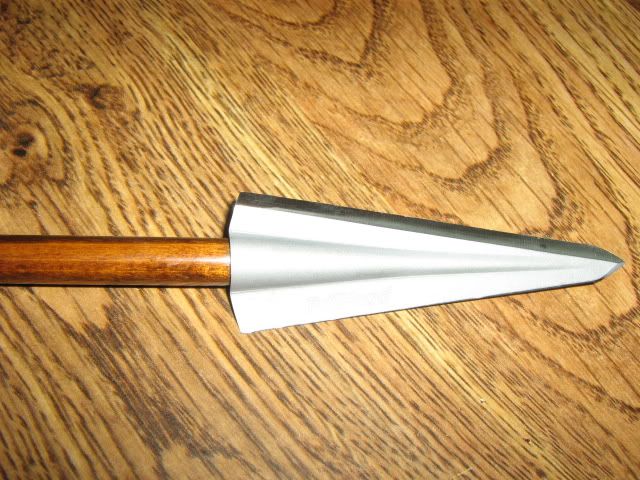

                                                Allow me to add to your great update, friend David?
                                                For those of you with interest I thought some photos to give you a proper perspective of the Tuffhead would be informative so I took a couple to share.
                                                The .060 thickness makes for a SUPER nice bevel width. All the more leverage for it’s purpose, eh Doc Ashby? I can only imagine (and drool) thinking of what the bevel on the .080 projected thickness of the 300+ grainers will look like!!
                                                Shown next to the ever popular Grizzly single bevel for comparison of the bevel width as well as the over all length and width and also with a Magnus II head as well since many are familiar with this head or the many other various heads that are similar in shape and size.
                                                When stuck on a 11/32 POC the size then appears better in perspective too.
                                                Hopefully this will provide a clearer overview of the Tuffhead’s characteristics. 😀 I know holding it in my hand with the other heads available it was indeed beneficial and informative so thought I would attempt to share this online with my tradbow friends.
                                                “A picture is worth a thousand words” ……and all that! 😀
                                                God Bless!
                                                Steve Sr.
