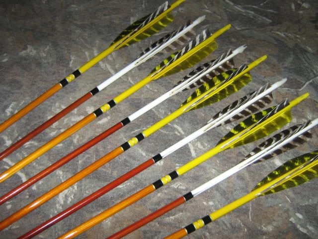

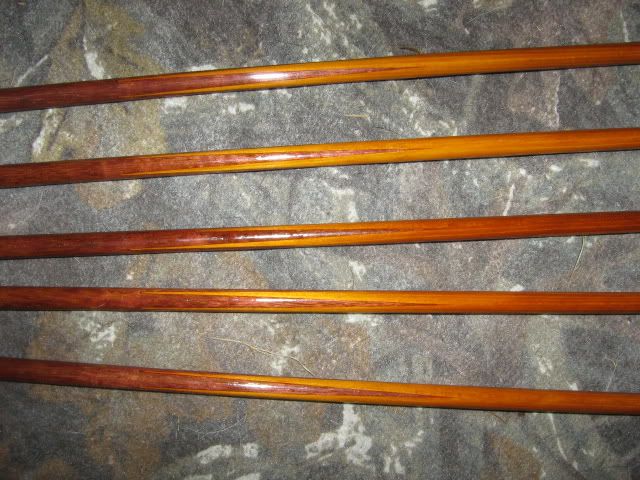

        I “happened” (aka searched and searched and searched) for some AFFORDABLE (there is always a catch!) TAPERED, FOOTED cedar shafts of heavier spine (I shoot weenie bows) and not so heavy shaft mass.

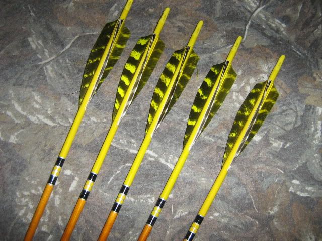

        Those I found are 11/32 tapered to 5/16 footed with cocobolo (pretty dense stuff there) that were 20lbs over my bow weight in spine. Granted, some “customizing” on the centershot may be up and coming to get proper arrow flight but…..doable. (The fact that they have my beloved NATURAL barred turkey feathers made it a “no brainer”!) πŸ˜‰

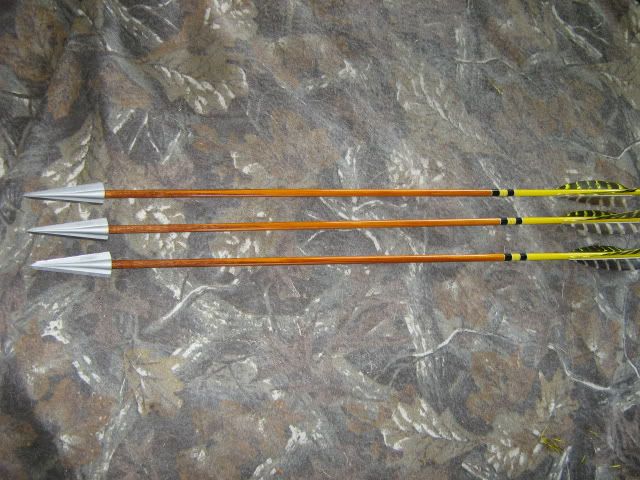

        They came about an hour ago and I slapped the 225 grain Tuffheads on and broke out the tape measure and grain scale.
        A couple surprises were in store for me.
        First, even with the 225 grain head…total mass was exactly 600 grains. Hmm (note that the 300 Tuffheads WOULD BE 675 grains πŸ˜‰ …….IF I can make em fly outa something).
        Second, the balance point was 6.75 inches forward of arrow center or 23.27 percent FOC…….no adaptations to the shaft or weight added in the ferrule at all. YeeHA!
        Ive come very close to 20 percent with other wood arrows but never crossed that mark. With a bit of lead in the ferrule both the total mass and the FOC will increase.
        The “kicker” is, of course, how they fly when done but feel confident I can adjust the bow’s centershot to the arrows for yet another set up to take afield this fall.

                      I keep rattling on about “my Sweetlands” and, if you would be so kind as to let me spout a bit more, I thought maybe a few had not had the pleasure of really comparing Bill Sweetland’s Forgewood shafts to others.
                      3/4 of an inch shorter and obviously VERY small in diameter the Sweetlands, shown here with these same footed, tapered arrows, OUT WEIGH the longer, larger diameter arrows a full 110 grains. πŸ˜‰
                      I had three earlier but recall how “fumb downded” I was the first time I had one in my grimy old paws!!
                      Sorry to praddle. These still grab my attention in a big way. One set with 4-5 percent more FOC (and over 20) yet the other has a smaller diameter and much heavier. Should make for some “interesting” results to compare should I do my part!!!! Odds are both will shine brightly in their own capacity.
