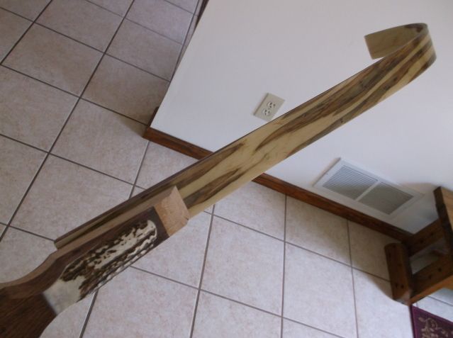

        That is right, since finishing Bill’s bow I decide I needed a fancier bow. I had to see if I could out do his for looks.
        Some of you may like this one, some may not.
        For me, think it’s going to be a keeper.
        Roughed in the riser and just pulled the limbs out of the oven and cleaned them up.
        I had a Red Stag antler I had picked up while hog hunting in TX several years ago and figured it would add some nice touches to the bow.
        More pics will follow as the work progresses.

              The riser is Hondurous Rosewood and Birdseye Maple with Black Walnut accent stripe. The limbs are Flaming Ambrosia Maple with A-boo core.
              Did the taper and tillering on the limbs. Right now it’s pulling 55#@29″. Final sanding on the limbs will have to be done very carefully to prevent loosing any weight. I have the antler tips and bolt plates glued on and as soon as the epoxy sets I’ll grind them to shape.

                                            Got the antler tips on the limbs and limb bolt pads dressed today. I also got a chance to shoot it for the first time. I really like the way it cast the arrows.
                                            After shooting I put the first coat of epoxy sealent on the limbs and third coat on the riser. Soon as I have all the grain filled it will be on to the Fullerplast.

                                                        Figured out this morning why the bow came out a little lighter in weight than I had expected.
                                                        Guess I can’t add any more. When I added the total stack thickness I came up with a higher number than it really was.
                                                        That and the glass I bought was supposed to .043″ After checking one of the drop pieces this morning I found out it was only .040
                                                        Drop acouple thousands by miss adding and another .006″ on the glass and now I understand why it came out light.
                                                        Whats the ol’ saying “measure twice cut once”? Guess I need to check figures and add twice, then glue up… LOL!!
                                                          Hopefully the bow will be finished Friday. I put on the three coats of Fullerplast yesterday. I give the Fullerplast 48 to 72 hours before doing any steelwooling to dull the high gloss.
                                                          I know they say it’s dry to the touch in 20 minutes, but like any other finish it needs time to cure. Otherwise it could lift if handled roughly like trying to dull the finish.
                                                          I’ll post finished pics later this week.

                                                              Finally got a few minutes this morning to knock off the gloss finish from the Fullerplast. I then added the shelf and sight window pad and started shooting. I can tell I’ve been lax on shooting time. Had to really work at it to hit anything consistantly.
                                                              Anyway, here is what the “Flame” looks like now. All I need is alot of shooting time and hunting season to get here.

                                                                      Oh but Troy!! The steeper or less angle will stack later in the draw cycle!!! Your design must be right where it needs to be unless you have really short draw length??
                                                                      Longer draw lengths need to have more angle!!!! Less stack as you reach your Anchor point. I much prefer the taller brace height and smoother draw over 5-8 fps that 2 degrees may gain in speed. By the way,,,, Beautuful Bow and thank you for sharing it!!
                                                                        Hiram,
                                                                        My draw is 29-1/4″. Believe it or not the limb bed angle is approx the same as most takedown recurves. It the straight limb design that makes it look as though the angle is low. I’ve checked the pounds per ince of draw and the bow has an average of 3# per inch all the way to 30″ draw. Havn’t pulled it past 30″ since my draw isn’t that long.

                                                                                Yes sir, shot it a couple times without the puffs and it did have some twang. After putting on the puffs it is church mouse quite.
                                                                                As for making a new Fronkenstein? No need, this bow is the same weight as the bow I was shooting last fall and I was lucky enough to get the shelf built out right for it to use the same arrows.
