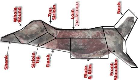

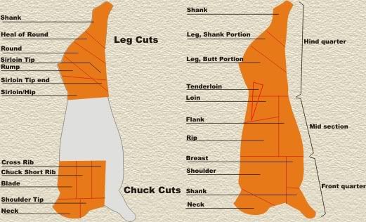

“Shoulder” is a collective anatomical term. It refers to an anatomical region (section) of the body; just as “hip” or “leg” does. The term “shoulder” includes all the tissues – meat, connective tissues and bone – contained in that anatomical region of the body.
The same terms are used in meat processing to refer to the same sections of the carcass. Here are some examples.

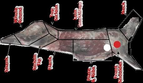

Here’s a processing chart for deer. The same entire region is correctly referred to as the “shoulder”. Note what constitutes the ‘shoulder’ region (section) of the body. It does not change from aminal to animal.

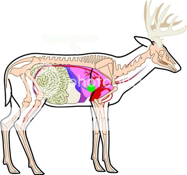

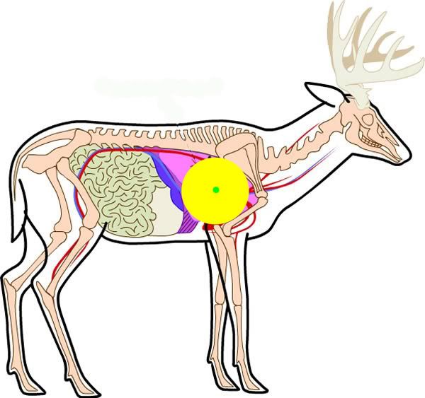

Now, if one is aiming ‘behind the shoulder” the aiming point would be where the white dot appears on the chart below. This is where every bowhunter education class I’ve ever attended (in the States) indicated as proper ‘behind the shoulder” shot placement.
When I speak of “aiming on the shoulder” I’m refering to an aiming point corresponding to the red dot on the chart above.

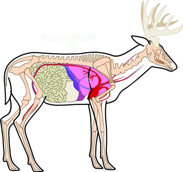

Here we have a deer standing broadside.
If you aim “back of the shoulder” the following will be your aiming point.

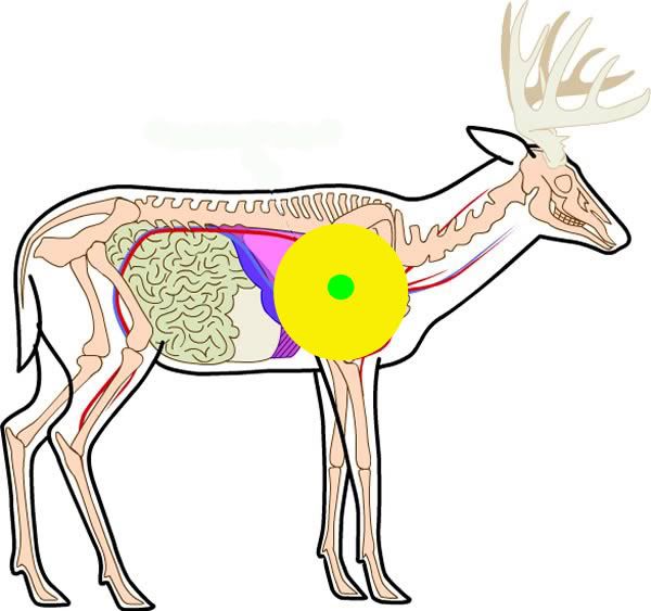

With an aiming point ‘back of the shoulder” this next diagram shows the size of the kill zone, before it first reaches a limiting edge of the thorax/liver area. Now think of the first movements a deer generally makes when it tries to “jumps the string”. It moves down and forward or down while turning either right or left. Think of where the deer’s body will be moving in relation to your kill zone. Use of this ‘back of the shoulder” aiming point is the major cause of hit too far back.
Using a ‘commonly used’ arrow setup, if you aim “on the shoulder” the following diagram shows the size of the kill zone, before it first reaches a limiting edge of the thorax/liver area. It represents a big gain over the ‘behind the shoulder” aim, and allows greater compensation for the animal’s potential movements when the shot is taken.
If you are using a penetration enhanced EFOC/Ultra-EFOC arrow setup having a mass weight above the heavy bone threshold the follow diagram shows the size of your effective kill zone with an ‘on the shoulder” aim. Because this type of arrow setup gives an ultra-high probability of penetrating any bone, or even any combination of bones, found in the ‘shoulder’ of a deer sized animal your kill zone is greatly expanded.
As shown, whether you are using a penetration enhanced arrow or not, the “on the shoulder” aim offers a greater zill zone than when you aim “back of the shoulder”.
Using an arrow setup that gives you the very highest chance of penetrating heavy bone offers other advantages, the above photos are all of deer standing broadside; which is not the most common shooting angle(s). Furthermore, the scapula is not always positioned as shown in the above diagrams. It moves as the position of the leg moves. That’s very likely where the advice to ‘aim behind the shoulder” originated. Here’s a diabram showing how the scapula moves as leg position changes. This particular diagram shows a bear, but the arc of movement of a deer’s scapula is virtually identical.

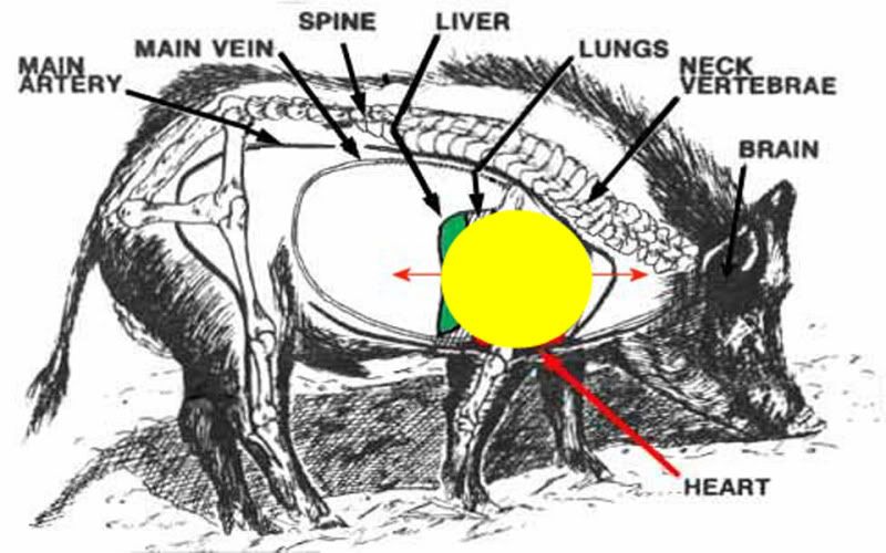

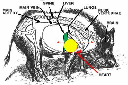

On some animals, sich as members of the swine and antelope families an aim ‘back of the shoulder” places you arrow extremely near the diaphram, giving an almost non-existant kill zone. Even with an ‘on the shoulder’ aim your kill zone will be small when using most ‘commonly used’ arrow setups, before the first limiting edge of the thorax/liver or heavy bones of the shoulder are reached. The following shows a ‘commonly used’ arrow’s kill zone with a “on the shoulder” aim on a pig.
Here’s what the kill zone looks like when you’re using a penetration enhanced EFOC/Ultra-EFOC arrow setup having a mass weight above the heavy bone threshold; a setup that is capable of reliably penetrating the heavy bones of a pig’s shoulder.
The “on the shoulder” aim’s location is best described as coming straight up from the leg to a point approximately 1/3 of the way up from the lower chest line.

It’s not about “we have killed a million animals this way” and “it has worked for hundreds of years” that’s just flat out stupid…… when there is proof that with just minor adjustments in equipment we can increase our killing effectiveness.

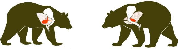

With out a doubt the quartering away shot offers the biggest and easiest way into the vitals.
This is more of a realistic view for the majority who hunt from trees.
This is more of a level ground view and if the deer takes a step and brings the humerus back it will cover some of the vitals, some times taking a step at the shot and spinning.
As you can see the bones are starting to cover up the vitals and this shot should be avoided, however some times this position happens after the broadside shot has been released and now your hunting tackle will be put to the test
For those who hunt from above, the scapula can come into play vary quickly if the deer reacts at all to the shot
The wild boar is tougher and can take a lot more punishment and keep going than a deer.
Shot placement is even more critical with boars, as deer are thin skinned and not built with that heavy of a structure.
This view is from an elevated position
Again quartering away offers the easiest way into the vitals, however can you see how far the spine drops down as it go’s between the shoulder blades bring the kill zone lower than a deer, aiming for the opposite shoulder is the best shot here and will get both lungs.
This view is at eye level and offers the best shot angle with the least amount of resistance
As you can see above a slight quartering at shot still has the vitals open, but shot placement is even more critical as the hog turns toward the shooter, also can you see that the top 1/3 is no vitals and you really must be at least down that far to get into the vitals.If a hog turns at the shot the bone can close the kill zone in a split second.
Some times it can be hard to till the exact angle the animal is in as they are constantly moving and not holding still like these pic’s for you to take your time.
This is a no shot -
Shot placement is critical for a good result.
The results I’m looking for lol 😛
King, those hog schematics are great. I’ve never been hog hunting (they don’t roam in my neck of the woods), but have considered going on one out of state. Without studying those first, I’d have likely blown it. The lower part of the body has no vitals!
David, those are some outstanding diagrams! I’m pilfering those for my library of useful information! There are many useful applications for such great examples.
Next, let me sincerely apologize for ever mentioning the game I’ve shot. Keeping the focus on the Study and off my own hunting has always been a personal goal. My response was prompted because someone had posted that bowhunters W, X, Y and Z had each probably shot arrows into more animals than the total number of arrows I had shot into test animals. It was the downplaying of the Study’s validity; the extent of its database; that made it necessary to set the record straight on the sheer quantity of data the Study’s results are based on; and to make it clear that the Study results are also backed up by actual field results on hunted game.
Now, let’s move on to more important things. Look at David’s last diagram; the quartering from the front shot. The quartering from the front shot was the least effective shot angle in the original Natal Study, and nothing since has changed that.
