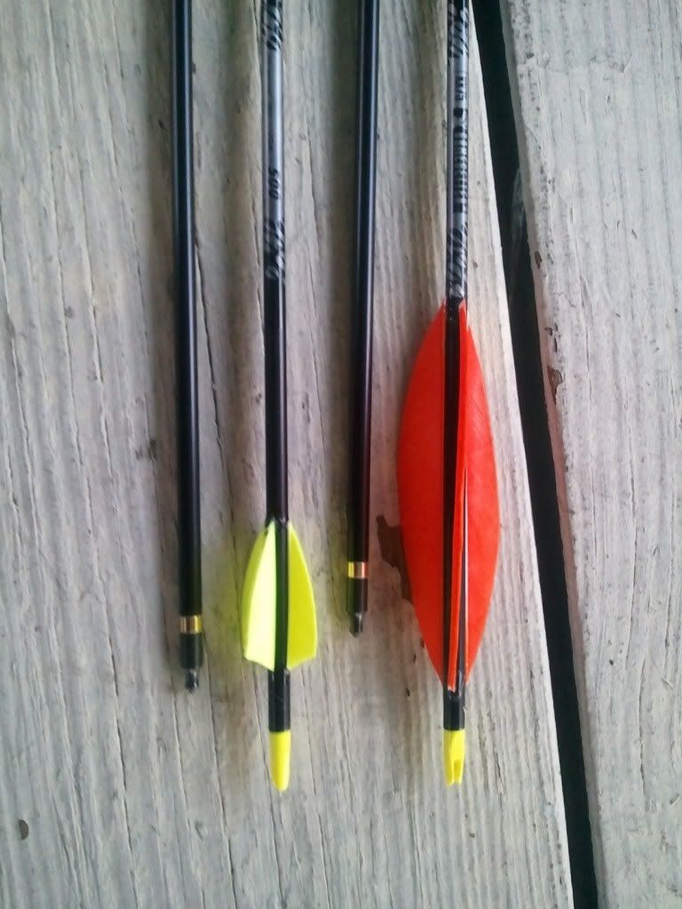

        Well, in another post, I asked about these fletchings. I wound up getting some Gateway 2″ Rayzr Feather and taking Dave P’s suggestion and going to 4 fletchings. Here is what I found (not scientific, just what I noticed while shooting):

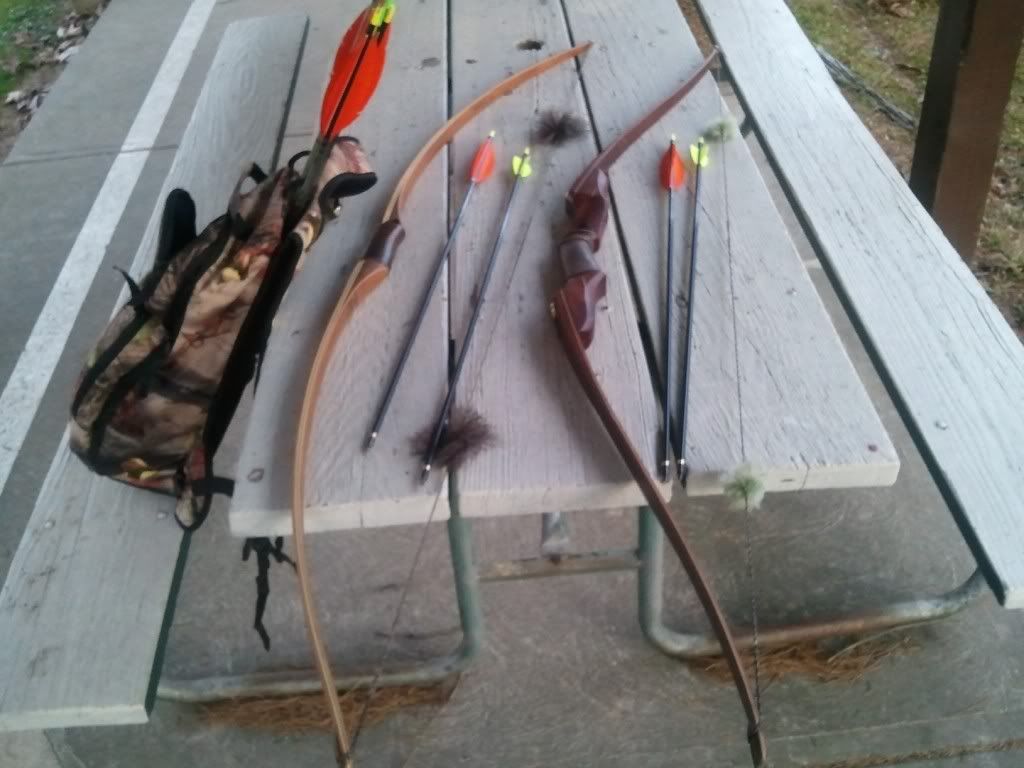

        First, the bows I was using. 1) my Java Man American LB, 66″, 52#; 2) my Crow Creek Black Feather Hybrid, 62″, 50#.
        Next, the arrows. I used Easton GameGetters XX75, 500 spine cut to 29.5″ with a 100 gr. insert. I used the ones I made first (3 5.5″ banana fletchings) and the ones I just made.

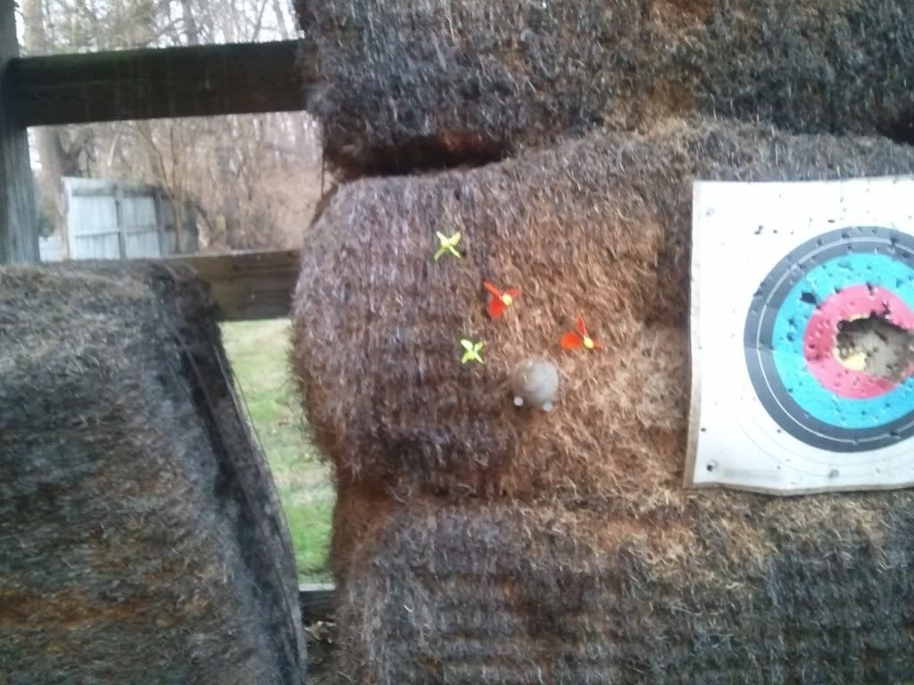

        I started shooting at 45 yards. I was not aiming at a target, just making sure I hit the background. I wanted to see how the arrows flew. To be honest, I did not notice much difference between the 4-fletch 2″ and the 3-fletch 5.5″.

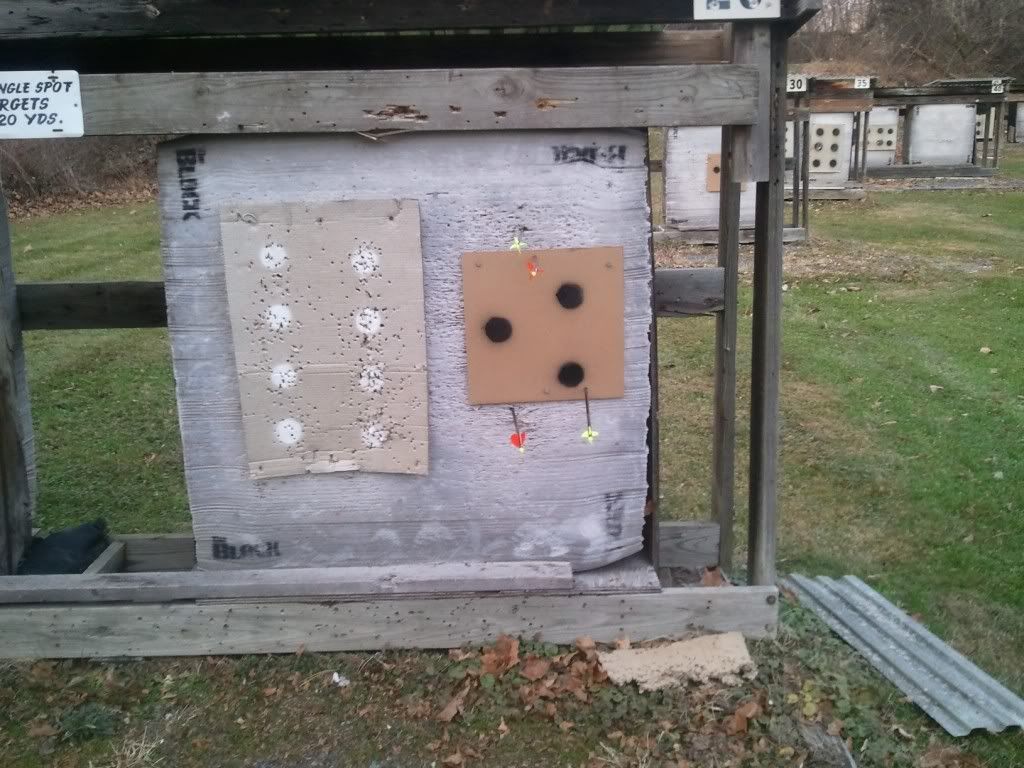

        Next, I went over to the 20 yard target. I shot one of each arrow from each bow. Yes, I need to practice more, but the arrows were pretty consistant.

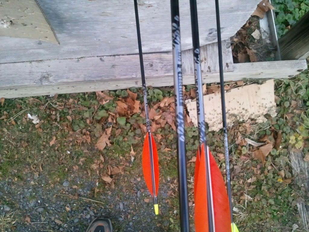

        From the top, they all look to be pointing in the same general direction as well.

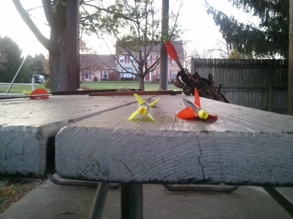

        I then moved to the 10 yard target. Again, pretty consistant (I consistantly miss).
        And from the top, also close, though I think a bit more off than at 20 yards.

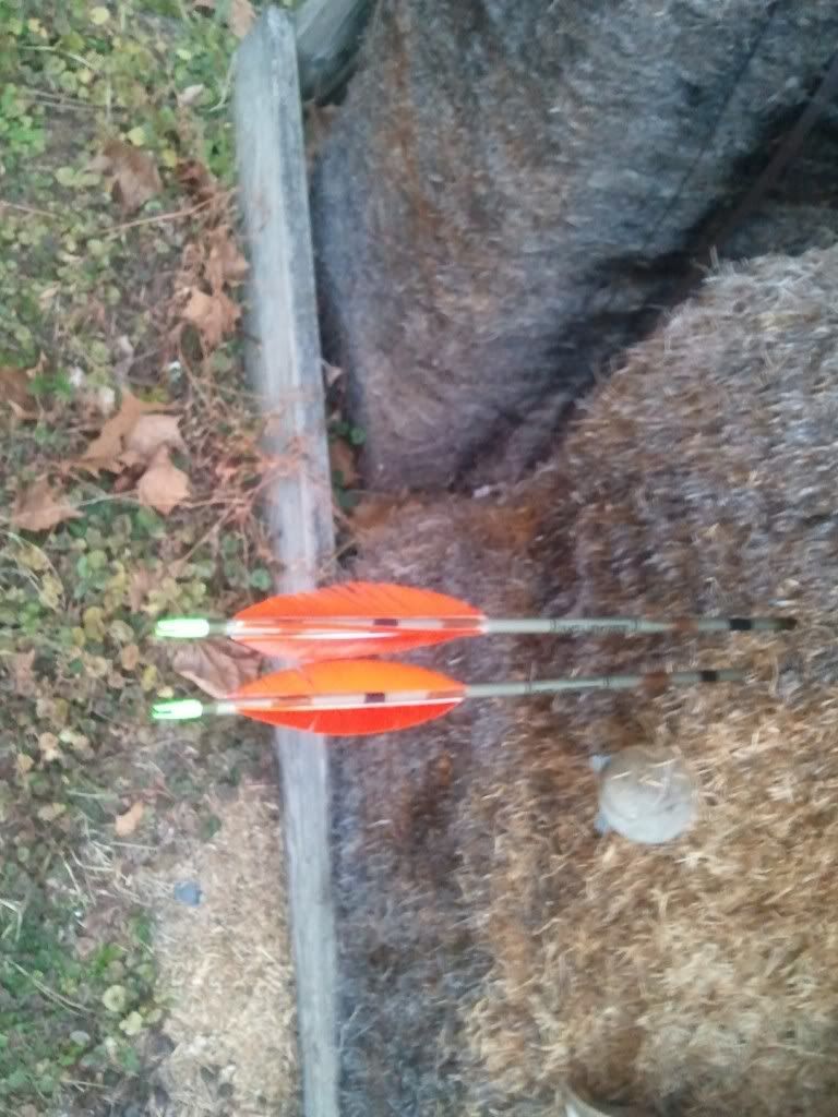

        I also shot another similar arrow (an Easton Camo Hunter in 2016 spine. It’s pretty much the exact same arrow as the GameGetter in a camo pattern. The main difference is that there were no weighted inserts, just the ones that came with the shafts). I shot one arrow from each bow at 10 yards to see if they were parrallel in the target.

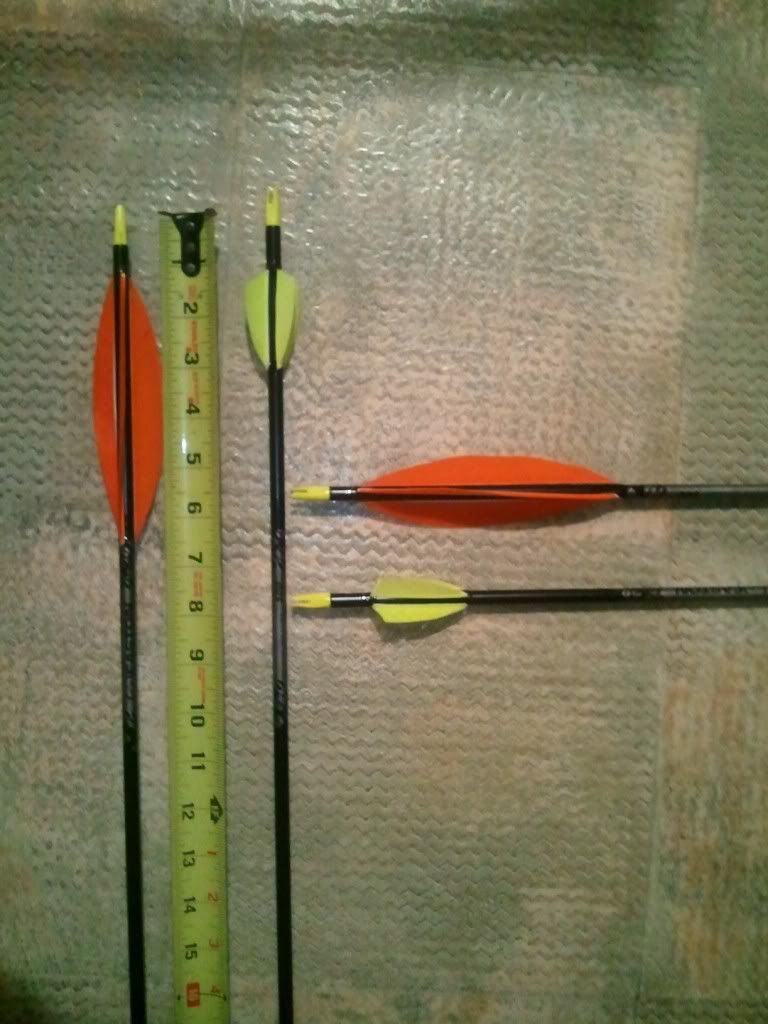

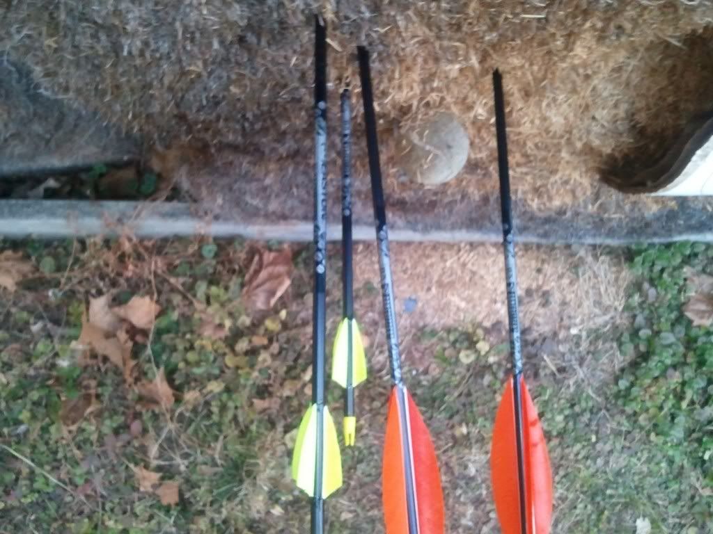

        Lastly, just so you have an idea of actual size comparison, here they are side by side with a tape measure.
