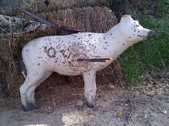

                                              I shot a 3D shoot with no fletching, with a tuned arrow you don’t need them, why in the world would I shoot 5 1/2″ nanners, all I need for broadheads is enough to overcome my broadheads from trying to steer my arrow.
                                                That just might be the quietest of all. Nice shots, too. I just cut 4 inch parabolic to A&A 3 1/4 and mounted them a little farther back and used a turbulator 1/4 inch ahead. We’ll see how they fly. Thanks! dwc
