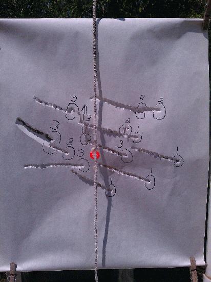

Here I numbered my groups 1 thru 3, cutting 1/8 of an inch after each group. All shots at 12 yards bareshaft. Group 3, I believe was off because if my sloppiness unless 1/8 of an inch could actually make that much of a difference . I know they all kick a little left but some feathers should take care if that. Troy, any advice would help. I’m almost there.
I will shoot the same bare arrow next week from group 3. If it is still shooting to the left of my Center line then its looking like 1/8 of and inch does have a major impact on arrow flight. This explains why Troy would cut the width of the blade at times. Amazing………If this is the case, then it looks like group 2 is the length I should pick and fletch. All shots are shot with my Bow in the Verticle position @ 12 yds with a Bareshaft. I started with a full lengt arrow and worked my way down 1/8″ @ a time. I’m used to shooting 29″ arrows. These arrows put me at 31 3/4 inches. (Beman ICS Camo Hunters, spine 340=10gpi) 360 up front.
i think that fletching with straighten this arrow out. I’ll be testing until this is resolved. 2 arrows at a time. Confidence in my gear is about 95% of the shot in my eyes. The last 5% is up to me.

I think you’ve got the right idea with trying those shafts again.
I’d suggest trying group 2 and 3. Start at the 12 yd mark, then back up to say 16yds and then to 20yds. You should see a difference at the longer yardage. If they hold to the same impact then fletch both sets of shafts and shoot. I also suggest (Ed may disagree with this) once you fletch, shooting with your normal form of shooting. If you normally cant, holding the vertical can cause you to shoot slightly to the left. Also if you normally cant, it takes a bucket load of discipline to shoot holding the bow vertical.
In my thread, remember I had a tail left problem. After acouple of super minor cuts my shaft made a big improvement in shooting straight. From your picks it looks like you have basically tail left kick, not enough vertical to be concerned with.

Troy Breeding wrote: CS,
@ 20 yards group 3 whas hitting about 3 to 4 inches to the right of my target with a bareshaft. I’ll be making microcuts to tune this one out. So what you are saying is that I should be able to see a perfect little hole with this bareshaft once its tuned. So perfect flight is attainable with a bareshaft? I shouldnt have to rely on fletching to get this perfect flight, fletching will only stabilize my arrow quicker and get it out of it paradox quicker.

Lets just say that “if” you can get that perfect bullet hole then yes, fletching will only have to stabilize the shaft and rotate the broadhead. However, getting that bullethole will is tough.:shock: I thought I had my shafts clean enough to punch bulletholes until I fletched.:cry: It’s amazing what one can miss when you put something on the tail of a shaft that will allow you to see everything. I know they say fletching is supposed to stiffen the shafts dynamic spine. I’m starting to believe it will, but not right off the bat. Thats where I was seeing the kick after fletching. Once the arrow was down range it would straighten up and fly clean. Shooting through paper may be that little tick that will show everything. Still, I like to tinker and paper would cause me to loose out on tinker time.:D

Yes, that’s what bearshafting is used for. If your shafts are tuned properly then your shots with the fletched arrow will be right on.
