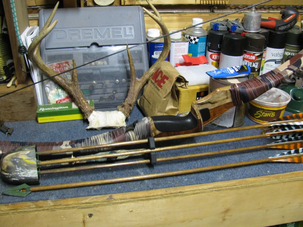

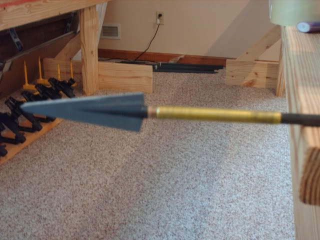

                            Looks like I’ll be the first to post pics.
                            Bow is a recurve of my design. 62″ 55#@29″, I stippled the grip to help prevent slipping when I sweat or while wearing cotton gloves
                            Arrows are Victory VMaxx HV 300 with brass inserts and 3″ of 2117 aluminium footing.
                            Broadhead is 190 grizzly with 125gr steel adpt.
                            Total arrow weight is 680gr, UEFOC 32.46%
                            Fletching will be switched from the 3″ parabolic to 2-1/2″ A&A
                            I use a Cavalier Tab
                            Quiver is a Selway softkot 5 arrow

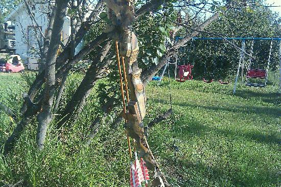

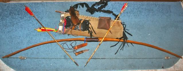

                              Here is a pic of my bow.
                                Here you go. Jim Reynolds’ Hunter model longbow. 45#. Carbon Express Heritage 150’s. 125 gr Magnus broadhead. I missed a big Mi. buck last year with a less than the best set up (still only a few years into this) – waah! This year I hope to poke him in the ribs with this:)
                                  I got a Super Shrew 50# @ 28″ last year but I don’t like the arrows I have made up for it. Too light. Turned out to be 450 gr total weight. I’ll wait and make up something better than those for hunting.
                                  So in the mean time I’m shooting my Volcano 45# @ 28″ Hickory shafts with 110 gr Zwickeys, 500 gr total weight.
                                  Should be OK inside 20 yards. Schrade 152 and Schrade 171UH

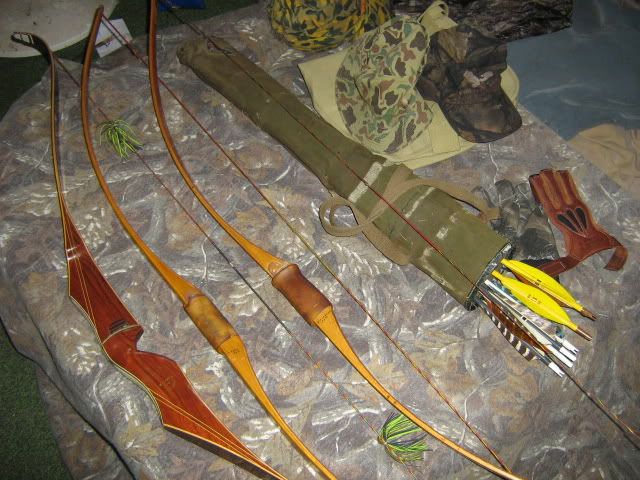

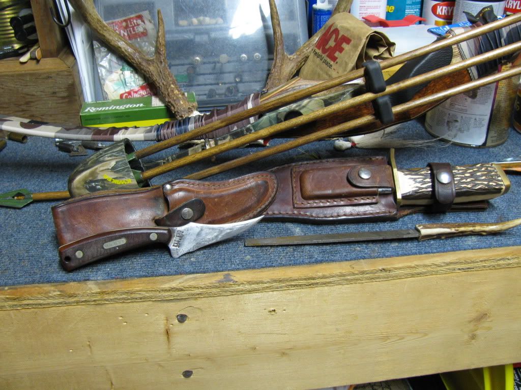

                                                                My mismash of hunters.
                                                                Left to right
                                                                1966 64 inch, 42lb Kodiak
                                                                1952 62 inch, 46lb Bear Cub longbow
                                                                1952 64 inch, 50lb Kodiak static recurve
                                                                State of the art..(I dont have a clue what it is) canvas side quiver that has “brushes” inside to center the arrows and metal “ribs” to hold the shape, full length zipper.
                                                                My crossover “Big Jim” glove, goretex cap, reg cap…..and “old lucky” hat. (See camo type? OLD Lucky, lol)
                                                                Under the hats is my haversack for “necessities” (flashlight, food, rope, knife, drinks, TPaper, book sometimes and yes…..my CAMERA, Doc!)
                                                                Arrows are tonkin cane, standard cedars (the two grey barred and white are 25 years old, bought new from Kelly Peterson) and some sweetland forgewoods, weights 600-710, FOC around 20 percent, give or take.
                                                                and Tuffheads of course with a Goshawk thrown in for nostalgia’s sake..
                                                                Camo dohickey in the top right of the photo is my 5 foot collapsible umbrella…..go ahead, laugh. ๐Ÿ˜€ I can stay out and NOT get wet OR use it for a partial blind, shade when none is available…etc.
                                                                and NOT working Saturday, opening day.
                                                                God Bless

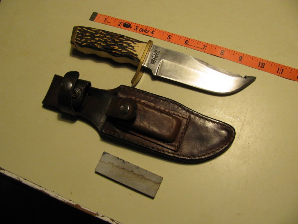

                                                                  Here is what I’ll be heading to the woods with Saturday Morning and I just can’t wait.
                                                                • Two rivers
                                                                    Post count: 16
                                                                    I am shooting a 55# Fedora extreme

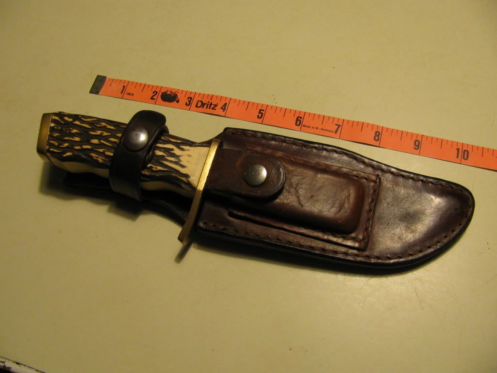

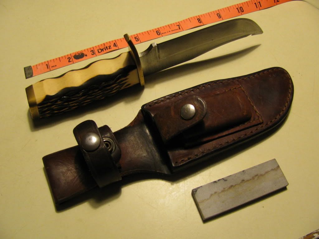

                                                                    28.5″ CE haratage arrow 220gr of brass up front with a 125gr 2 blade buzzcut. Arrow is 679gr. 22% FOC
                                                                      Duncan — That’s a unique and interesting-looking knife handle, appearing rectangular rather than oval in cross-section. Make it yourself? Let’s see a pic of the entire knife if you don’t mind. Looks like my kind of hunting knife, with a handle at least as large as the blade for a good solid grip to provide max torque.
                                                                      I hope I’m not snatching the thread, as the topic is fall hunting set-up, and knives are a part of that. ๐Ÿ™‚
                                                                        Well, I included two of my favorite knives in my setup pic so I think questions about them are as relevant as questions about bows. Not trying to hi-jack the thread, to answer Dave’s question, the knife is a Schrade Uncle Henry 171UH. They never were as popular as some of the lighter weight Schrade knives but I like it with its own honing stone it is somewhat utilitarian but is a nice looking knife with some heft to it. Sadly, the new ones available are made in China now but USA made models can be found on e-bay and some knife forums. I found mine in a vintage jewelry shop in Virginia.
                                                                        The gut hook was added by the previous owner which diminishes the collectability of the knife but I wanted it to use so I don’t mind it.
                                                                        Duncan

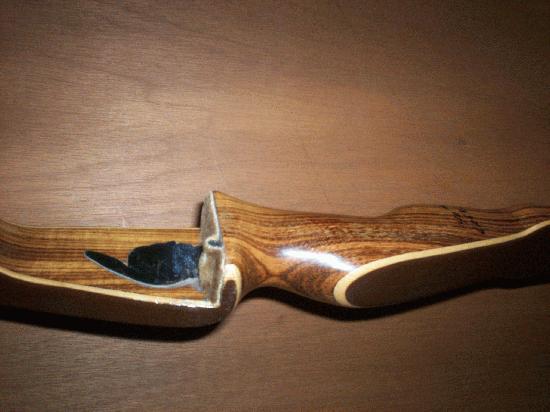

                                                                                  Got this off ebay for a steal, just arrived today and this hot hunk of wood puts ’em in the 10-ring!
                                                                                  Diamondback Rat’ler T/D longbow
                                                                                  66″ 48# @ 28″
                                                                                  My traveling bow issues have been solved! Now just need a solid case. Any suggestions?
                                                                                  I hope the picture posted…
