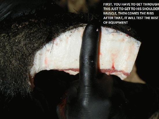

      • kingwouldbe
          Post count: 244
          This is just his skin, not muscle. 😯

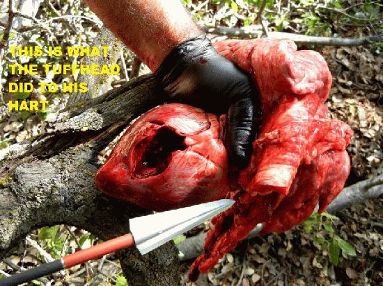

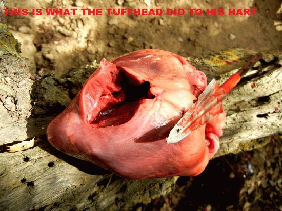

                                        Ed have you seen this type of hole before? it looked like a quarter of the heart was pealed open, yet I could close it all back, it did not look like it was sliced multiple times like I first though.
                                      • ozzyshane
                                          Post count: 13
                                          David maybe the arrow hit right as the heart was expanding and it poped as it looks like it is a rip to to left of were the head entered .Thansk Shane

                                          • Ed Ashby
                                              Post count: 817
                                              David, go to the article on “Why Single Bevels” (here’s the link: https://www.tradbow.com/members/223.cfm) and check out photos number 17 and 18. That’s the classic ‘L-shaped cut’ that single bevels often give. Besides on some exits I’ve seen it on hearts, kidneys and livers. On the 1″ wide modified Grizzly the 2 sides of the L-cut (combined length of each leg of the cut) usually measure very close to 2″, often a bit over that.
                                              The somewhat longer length of the TuffHead SHOULD give an even larger L-Shaped cut, due to increased tissue ‘windup’ around the blade.
                                            • kingwouldbe
                                                Post count: 244
                                                Doc. I remember seeing and reading that article, I have seen it on the hides of some animals, just never on a heart, and the hole in his heart was about 2″ just like in your study.
                                                How on earth could I fake the same thing you faked in your study 😯 Did I say that out loud ………………..OH! that’s right you did not fake anything, you just reported your findings.
                                                That’s amazing that I could get the same results as you got on a buffalo, I will say; that on a hog of this size, I want more penetration, the Tuffhead did go right through the thickest part of his shield and that stuff is so hard, there is no doubt in my mind, that if I was using a wider or a 3 or 4 blade head, I would of never made it into the vitals of this dude, his shield just eats up anything that tries to penetrate it.
                                                It would of been another big boar story about the one a guy hit perfect yet, they never found it, ( I hear that story way to often )I find it absolutely amazing how tough a big boar is.
                                                As I have said before, you can kill smaller or immature boars with some really light tackle, and your arrow will jump through them like budder, however as they age they begin to grow a shield, and it gets thicker and thicker, this boar was around 7-8 years old, there last set of molars don’t come out until the 5th year and his where wore down.
                                                If your looking for a meat pig shoot one under a 100lb, this dude smells like the Coliseum urinal @ half time, um strong smelling if you get my drift.
                                              • Ed Ashby
                                                  Post count: 817
                                                  David, this is an excellent example of why close examination of the soft tissue damage is just as important as taking note of the ‘hard tissue’ performance. The more you look the more interesting things you’ll find. The single bevel’s L-Shaped cut is only common on exit skin, the heart, liver and kidneys. ‘Mushing’ of lung tissue is a common feature, often creating a ‘hole’ rather than a slice.
                                                  I hope it isn’t often that you get the chance to see it (and you have to look closely for it to see it; I had to use a dye injected into the intestine to find all the cuts) but the ‘starburst’ cut that single bevel heads often make through the intestines is truly impressive. It represents more damage to the intestinal tissues (and vessels) than that caused be either a double-bevel, wide cut 3-blade or double-bevel, wide cut 4-blade; something like a snuffer or a Delta 4-balde.
