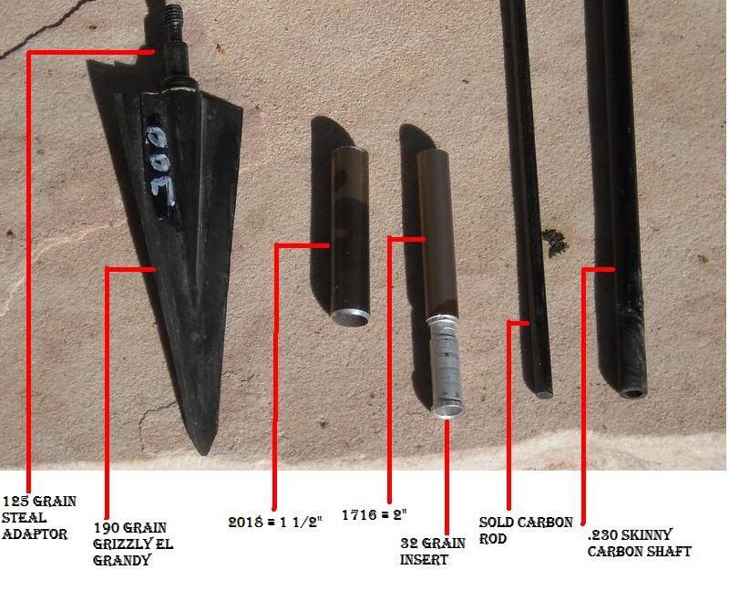

          I have been working on using the info you have shared to make my next KILLER arrow.
          I am using a sold carbon rod around 12″ long for the spine it adds to my arrow( I still need more testing ) so far, I like it more than doing 12″ of aluminum outsert footing.
        • kingwouldbe
            Post count: 244
            This is the arrow I made for my Elk hunt this year, it might get some Hog action also.

              Looks like a killer setup David. Structurally that should be a good, tough arrow. With so many variable component parts how hard was it to get the tuning right? It going to be interesting to see how it performs. Have you tried any adverse angle punishment test shots yet?
