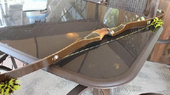

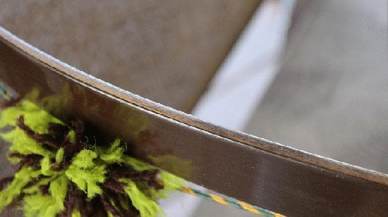

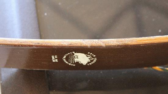

        I recently got back into shooting my old Bear Grizzly 58″ 55# recurve, but I’ve started to notice a lot of wear on the sides of the limbs. I don’t want to refinish the entire bow because most of the finish is still fine, but I’d like to seal it so that it doesn’t get damaged by moisture. Does anyone have any suggestions as to the best way I can fix up these areas?
          There are alot of good exterior finishes on the market. Spar urathan is the best in my book if using a spray can version.
          However, if you want full moisture protection (or as best as can be expected) make your own (commomly called the Massey Finish) by mixing slow set epoxy (30 minute or longer set time if you can find it) and acetone. One part epoxy to three parts acetone and apply to the sides of the limbs or where ever with a rag or q-tip.
          Don’t spend alot of time trying to rub it out smooth. Just apply and let flow out smooth on it’s own.
          Put on two coats in no less than 8 hour intervals, allow 8 more hours to cure (12 is better in my book) then lightly sand with 220 or finer sand paper. Afterwards do it again. If at that point the area is fully covered and smooth you can use 0000 steel wool and buff to a satin finish. If not go with the two coats of mix again or until the area is smooth.
          Any of the epoxy finish that gets on the glass can be wiped off while wet or lightly sanded and feather edged once dry. Then buffed with steel wool and will hardly be noticed.

            Super glue. If it’s too shiny after you apply it, use some steel wool very lightly to remove the shiny appearance.
            Bill
              Forgot to say the area to be refinished will need to be sanded and free of any old finish before trying to refinish.
