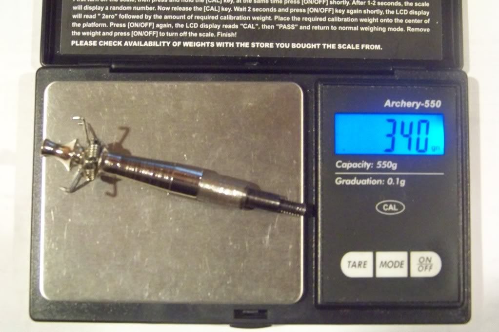

Great idea Sapcut!!! Now why didn’t I think of that???:roll:
I wish Zwickey would come out with a heavier version judo for we guys that shoot heavier bows.:?
