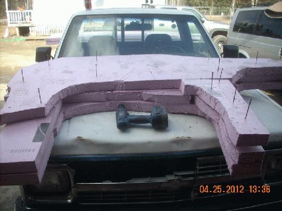

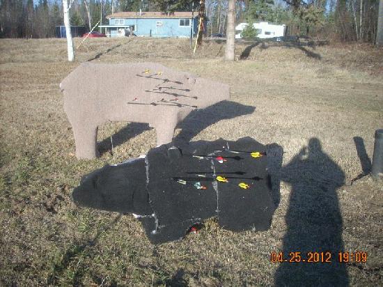

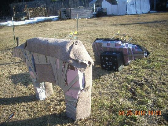

        I tested my prototype black bear target and it work pretty good so then i made a build along for the brown bear target
        i made the black bear for $40 and the brown bear for $80

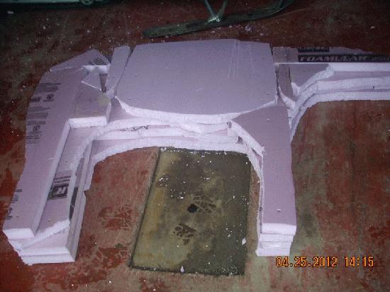

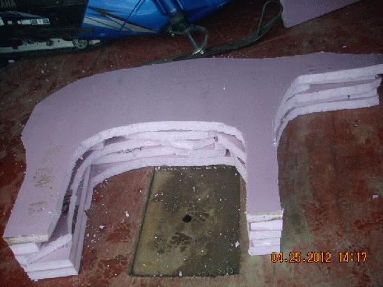

        It is real easy all you need is some 250 pinkboard 2in and 3in deck screws and carpet and last but not least duck tape
        And then you mark the shape of the beast your trying to make and then cut it out and use the scrap as fill useing the screws [for my 75 lb long bow with 790 arrows] it take 4 layers to stop the arrows but i used 5 layers so that it will last longer
        Once you make the 2 outer layers then you can use the fill for the other 3 layers as you can see in the photos and the you duck tape it so that is is solid and then you can cut the carpet to fit and use screws to hold the hide on
        Me and My Dad like them
        My plan is 2 bears caribou moose mt goat dall sheep and all life size like i said the black bear was a prototype
        heres the pics my next is caribou….

          Hey! those turned out really cool!
          well done!
          the carpet is a great “finishing touch”

                getting the shape right is harder then it seems
                at 20+ yards the carpet looks more like hair
                the next ones will look alot better
                also my buddy shoots a 70lb compound and they stop his arrows just fine
