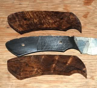

                                  When I asked Patrick what type of wood he would like, I showed him a picture of one of the knives I had done using Stabilized White Ash Burl and he really liked it. Well, Patrick was in luck, I had two sets of highly detailed S.W.A.B. left and it would really look great on his knife so this is where the custom fitting starts.
                                  I took Patrick’s old plastic ivory scale and used it as a template on the new handle material. I basically needed the front portion of the handle as I needed to grind that down before fitting the wooden scale on the blade. I like to clamp the scale to the knife handle using vice grips because it does not move and I like to leave enough room so I can use a ball level either to the front or the rear of the handle to ensure I am drilling straight up and down. This also helps in the final fitting, as everything goew together pretty snug.
                                  This is what I meant by using a ball level, it’s pretty handy let me tell you.
                                  Once the holes are done in the first set of scales, I simply have to repeat the same process with the other side.
                                  Here is the picture showing you the finished holes on one side. That is going to be one fine handle.

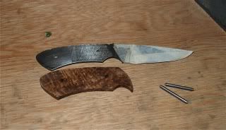

                                        In this picture, I cut two stainless pins and placed them beside the knife blank and right side scale. I made two pins because I’ll need them to fit both scales together to replicate the front curve, so that they are both identical.
                                        At this point, I took the time to choose a nice fitting wood grain design for the left scale and clamped it to the blade. You’ll note here that I added a blue pen that points to the front of the scale. It really doesn’t matter it the front of the scales match at this point because we’ll do that in the next step.

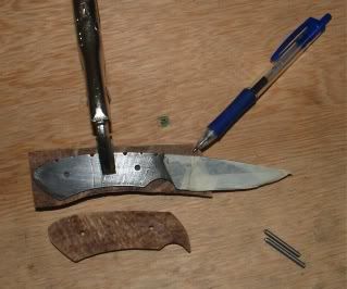

                                          The next thing I done was to bring the present set-up to the drill press and make sure using a ball valve level that I drilled my holes straight up and down.
                                          Once I finished doing that, I took the two stainless pins I cut earlier on and put the two scales together. The reason I do this is to use the first scale and use it as a guide so I can trace the same shape and or curve on the other scale. Makes things easier.

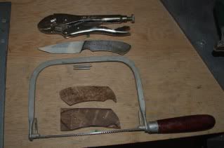

                                          Then with a coping saw, I cut out the front of the scale allowing myself to leave a bit more wooden material so I can grind them down later and get both fronts even and of the same shape. Its so important here to completely finish both fronts together ( sanding and buffing ) because if you don’t do that here, its very hard to do so when you have everything glued up. You increase your chances of damaging the blade with sand paper.
                                          Now that we have the fronts all shiny, its time to get those two wooden scales apart and cleaned up. The scales actually look pretty good at this point.

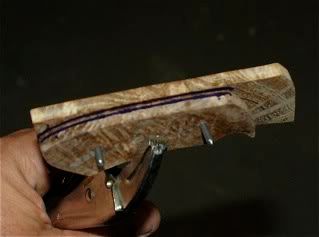

                                            Since the stabilized white ahs burl are so unique, I choose to use nickle silver pins. The colour of the nickle silver will add a nice complicity to the already accented flames in the right and left wooden scales.
                                            The one problem I seen in using nickle silver pins is that the stock material comes pretty polished and I like to rough the sides using 120 grit sand paper on my lap wheel. The rough surface really adds to the epoxy adhesion when you glueing and securing eveything together.
                                            Something that is making me smile is this, the wood design/patterns will really balance well with the damascus blade.
                                            The next step is also very important, using 60 grit sand paper, I basically rough up all the surfaces that will join together. I then put on all of my protective gear and use acetone to clean the handle, scales and pins.
