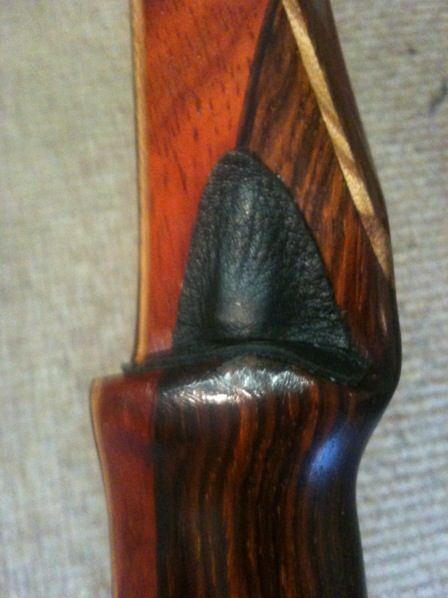

Fish – I also shoot the CE 250’s with close to 300gn up front. The latest bow I built I cut the shelf to center where I normally cut my shelves a bit short of center. My CE 250’s were shooting a little weak, hitting to the right. I built out the shelf with a couple layers of leather little by little until I was back in line.
Here is a pic of how I built it out…
I simply put small pieces of leather behind the larger piece.
BTW – This bow shoots 51# @ 28. I draw 28″ my arrows are cut to 29″ This bow is 58″ ntn with a nice fairly aggressive r/d.
Hope this helps…
