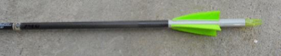

          For any unfamiliar, here are a few photos of the A&A fletch. Their appearance does take a bit of getting use to. The red ring is the turbulator.
          #1: With EFOC 0.5″ tall, 2.5″ four-fletch A&A works for my very poor quality finger release. Once I get a good Ultra-EFOC setup I may be able to go smaller.
          #2: 0.5″ tall, 2″ three-flect A&A worked with mechanical release from Wesley’s compound. This is the fletching we water-soaked and tested.
          #3: Compare the fletching surface area between the 2″ A&A and the 3″ parabolic cut fletching. When thoroughly water soaked the A&A still stabalized the broadhead’s flight; the 3″ parabolic didn’t.
          #4: Looks starnge; works great!

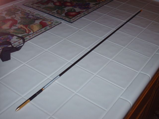

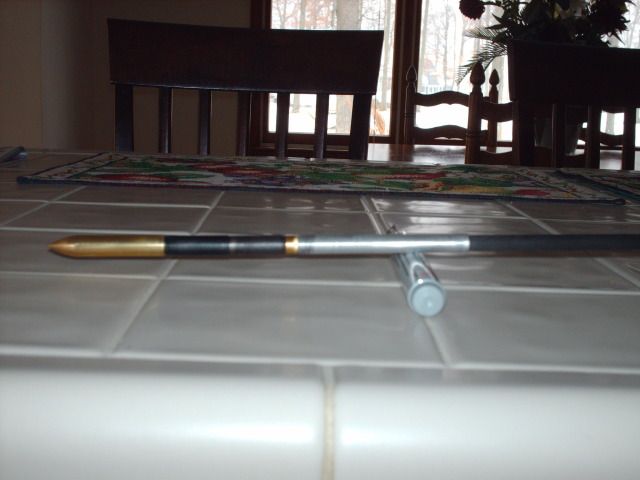

            575 grains and 29.2 percent (top) and 585 grains and 30.2 percent(bottom) is the weight and EFOC on these two. The bottom is next up to bat! (it has the head of discussion from our PM swap, Doc. GOTTA DO IT).

                Dave, the turbulator is the tiny raised red band you see in the photos, located 1/4″ forward of the fletching. It’s a piece of pinstriping tape – available at most hobby shops. It acts to disrupt the ait flow, increasing pressure on the fletching. It works too. I can go down to a fletching size that won’t stabalize the broadhead, add the turbulator and presto; total stability again.
                We’re getting both types of testing. When it comes to any potential accuracy effects I tend to turn to Wesley. There’s just no way I can shoot accurately enough to tell exactly what’s happening. Wesley is as close to a shooting machine as anyone I’ve ever met.
                With my very poor finger release I have to use a 2.5″ four fletch. Those works on all my EFOC setups, from sub 650 grains to 900+ grains. I’ve tested and hunted with them on the EFOC setups for almost 2 years, and have had nothing but fantastic results. I’m hoping that I’ll be able to go a bit smaller on the fletching on an Ultra-EFOC setup.

                        I couldn’t help notice that those super short feathers are more akin to a shield feather shape. I wonder if these would suffice (as I don’t want to get into cutting my own feathers…call me lazy…that’s fine :-):
                        http://www.gatewayfeathers.com/2009-rayzr-feathers.html

                          Patrick, as far as stability it’s the fletching surface area that matters. The A&A pattern has a straight, vertical cut at the fletching’s rear. We have experimented a fair amounht with the sound in flight (with approximately same surface area but different fletching shapes) and the absolute square (vertical cut) trailing edge is the most silent we’ve found.
                          Uning a wrap with turbulator is no problem from a functional standpoint, it works well. Just add turbulator on the wrap. Be sure the wrap is fairly long, so its leading edge is not anywhere near the turbulator’s position. I don’t use wraps on any of the EFOC/Ultra-EFOC arrows. They just add unnecessary weight at the shaft’s rear, reducing FOC. It is also helpful to keep the fletching as far back on the shaft as you possible can (while leaving clearance for your fingers). This increases the length of the arrow’s rear stearing arm – the distance from the arrow’s center of pressure in flight to the point where the fletching’s stabalizing pressure is applied upon the shaft.

                                    “Hi Steve, how are you getting such high EFOC on such light arrows? there not that light, just lighter than mine.”
                                    In the case of these, the arrow weighs 6.98 GPP and Im only shooting 43lbs, which allows for lots and lots of head weight to tune it. Shooting a 60 or so like you, I couldnt do it.
                                    I’m of the opinion this bow weight coupled with the factors of the Ashby Report, I will indeed get penetration far and above what I had previously shooting heavier bows chosen FOR more penetration. Therefore, I’ll have little reason to shoot heavier bows and will be able to shoot this weight for the remainder of my hunting life, with great results.
                                    I also have a standard 28 inch draw. For the first time in my life I see an ADVANTAGE (of sorts) to a short draw (shorter than mine I mean). Less shaft weight with lower spine shafts having lower GPI.
                                    With a shaft weight of 200 grains, you can see what I had to play with for arrows of this weight.
                                    One I would like to TRY, but hear horror stories on is the carbon pro arrows shafts from High Country archery. 5.5 grains per inch “up to 80lb spine” but dont know the deflection measurement on them. I do hear A LOT that they are “brittle” so……hmm.
                                    Doc Ashby did give me advice that I “knew” but had not put into play (aka forgotten).
                                    You can build out your arrow rest or flat use a bow NOT centershot and the spine of the arrow needed will be drastically LOWER than one center shot allowing for much lower spine shafts that have a much lower GPI as well that allows for less rear / shaft weight.
                                    It gets to the point, for me at least, that adding MORE weight up front, even if the spine requires it flat dont give much in way of EFOC once about 25 percent is hit, yet using less weight in the rear does.
                                    That is logical mathmatically since the length of “lever” on the feather end of a 25 percent EFOC arrow is 3 times that of the front. I reduction behind the fulcrum of balance, has greater impact on the EFOC several times that amount added to the shorter front “arm”.
                                    Correct any errors Dr.Ed!!! 😆

                                                                          Only issue I had with AA fletching is I just flat couldnt see the arrow fly OR hit very clearly.
                                                                          When I was about to spend MORE money on lighted knocks, I sat back and mused a bit on it all and for hunting purposes I went back to the big, hard helical fletchings on woodies like used for several decades.
                                                                          A *astard of two worlds I love tinkering with arrows but nostalgia just plays WAY to big of a part for me to ignore it.
                                                                          Even contemplating taking some 1942 arrows and heads out from Ol Ben and sticking a deer in his memory.
                                                                          Sometimes, for me, it’s a lot more than what works best but please recall, I totally agree this is a total package arrow set up that flat SHOOTS following all Doc’s information.
                                                                          My fondest hunting memories consist of seeing the arrow spin out and connect and the two deer I shot with AA fletching…I flat did NOT see the arrow hit and on one of them that was a “not good” thing.
                                                                          Even though they flew great, I stripped and refletched them so I could see them hit.

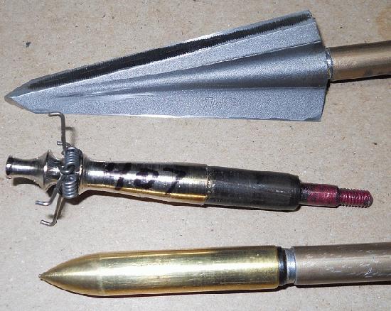

                                                                                                                                                                                                            Regarding the topic of UEFOC arrows, I have continued my life’s ambition as an arrow scientist wannabe. My latest information I have gathered is using a lighter insert and using that weight in the broadhead instead.
                                                                                                                                                                                                            The TuffHead 300 is definitely my new favorite for two reasons. One is the benefit of the wider bevel. I think the wider bevel will twist more creating more cutting power. And the TuffHead 300 has allowed me to trade the 100 grain insert for a 15 grain insert and put that 85 grain difference in the TuffHead 300. The end result is the SAME total weight arrow with 1.3% more FOC. I know that’s not the most important accomplishment on this great Earth but it helps calm my tick.
                                                                                                                                                                                                            As usual I can use the 2317 footing to create a sleeve over the insert AND the extended shoulder of the broadhead adapter. This should sufficiently strengthen the aluminum insert. Finally, the sleeve fits nice and snug underneath the ferrule’s edge. It has a very smooth penetrating profile.
                                                                                                                                                                                                            The end product is a 31.25″ GT Ultralight Entrada 300 with 2317 over a 2117 footings, a 15 gr. insert, 170 gr. broadhead adapter, Tuffhead 300 and 3-3″ low nanner fletching. Total weight of 810 grains and 33.7% FOC shot from 71@31.

                                                                                                                                                                                                              I was playing around today on a judo to mach my Tuffhead weight.
                                                                                                                                                                                                              All with-in a few grains
                                                                                                                                                                                                              Tuffhead with 100grain steel insert for 400 grains total
                                                                                                                                                                                                              Judo with a 300 grain steel field point tapered to a 5 degrees, 407 grains total.
                                                                                                                                                                                                              300 grain Brass field point from Joe Furlong with 100 grain steel insert for 400 grains total.

                                                                                                                                                                                                                  That adapter you have in your judo is the way I’ve been making my heavy broadhead adapters for several years now. Look at the draw clearance you have added with the long adapter. Now you can cut your arrow shorter to create more spine for more FOC.

                                                                                                                                                                                                                    If I took one of these 300 field points ( after tapering it weighs 265 ) and put it in a Tuffhead 300 I could make a 565 grain broadhead, I might be able to catch up to Troy and his Airhammer with 40% UEFOC.

                                                                                                                                                                                                                                  The adpt I used to make the 40% arrows was 275grs

                                                                                                                                                                                                                                  The “Airhammer” arrow tips the scales at 992grs. I’d only be guessing, but to get 43% I would think the finished arrow would be close to 1200grs.

                                                                                                                                                                                                                                                            780gr point on a 425gr shaft.
                                                                                                                                                                                                                                                            Total weight before tuning 1205gr.:shock:
                                                                                                                                                                                                                                                            FOC at this time is 43.65% 😯

                                                                                                                                                                                                                                                              A couple of pics of the newborn.
                                                                                                                                                                                                                                                              First shot in the cradle.
                                                                                                                                                                                                                                                              Next a head shot. Can you see her smiling face.:D
                                                                                                                                                                                                                                                              I will keep everyone updated as she evolves into “something”:shock:

                                                                                                                                                                                                                                                                  What we need is someone to turn some 400, 500, 600, 700 grain broadhead inserts, then at least we can start to shoot it, to see if we can tune it.
                                                                                                                                                                                                                                                                  Troy,
                                                                                                                                                                                                                                                                  It looks like your stacking inserts on field points, it that right?
                                                                                                                                                                                                                                                                  I did internal and external footing to see if it would spine, but I don’t have anything heavy enough to shoot.
                                                                                                                                                                                                                                                                  With a heavy 500 grain broadhead adapter and a 300 grain broadhead, now we’re talking.

                                                                                                                                                                                                                                                                      It does have and internal and extermial footing. I used the same basic setup I used to make the “Airhammer”. Just increased the internial footing a tad.
                                                                                                                                                                                                                                                                      The point is a 279gr homemade adpt, 200gr woodie weight and one of Joe’s 300gr glue-ons.
                                                                                                                                                                                                                                                                      The toughest part is lining it all up so the shaft spins true. The homemade adpt is the problem. The angle isn’t exactly correct and I have to play with it a bit to make sure the complete setup spins right.
                                                                                                                                                                                                                                                                      I’m sure the weight will back off alittle and very well drop in FOC once I start tuning. The shaft is still full length. If it holds on FOC, I want have a problem with a slight drop in overall weight.

                                                                                                                                                                                                                                                                                          Thought I’d throw in these new pics.
                                                                                                                                                                                                                                                                                          This one the new baby on her first balancing act in public.
                                                                                                                                                                                                                                                                                          Here is a close up.
                                                                                                                                                                                                                                                                                          Wish the weather was better today. Still snowing, with winds of 15+mph.

                                                                                                                                                                                                                                                                                                                              Troy, I need all your specs on your arrow, including all parts used.
                                                                                                                                                                                                                                                                                                                              Thanks bro.
                                                                                                                                                                                                                                                                                                                                Kingwouldbe wrote: Troy, I need all your specs on your arrow, including all parts used.
                                                                                                                                                                                                                                                                                                                                Thanks bro.
                                                                                                                                                                                                                                                                                                                                I tink I tee a putty tat!!!!:D
                                                                                                                                                                                                                                                                                                                                No tweety, just a brother of the knowledge!!!
                                                                                                                                                                                                                                                                                                                                PM sent in a short Bro.

                                                                                                                                                                                                                                                                                                                                                                                                                                    • L82HUNT
                                                                                                                                                                                                                                                                                                                                                                                                                                        Post count: 27
                                                                                                                                                                                                                                                                                                                                                                                                                                        Made some 2.5″ long by.75″ high. They whistle very badly I’m guessing because of the height and angle. Cut them down to 5/8″ and quiet.
                                                                                                                                                                                                                                                                                                                                                                                                                                      • Ed Ashby
                                                                                                                                                                                                                                                                                                                                                                                                                                          Post count: 817
                                                                                                                                                                                                                                                                                                                                                                                                                                          You might want to try them at the ‘standard’ A&A pattern height of 1/2″; increasing the length a bit, if necessary. At that height we found them quieter but, more interestingly, virtually impervious to being wet. This appears to be a factor of the relative ‘stiffness’ of the 1/2″ high fletching. We were able to soak them in a bucket of water for a full 30 minutes, remove them and, without even shaking the water off, have them shoot to the same point of impact as when the fletching was dry (with a 190 grain Grizzly BH) at 40 yards.
