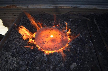

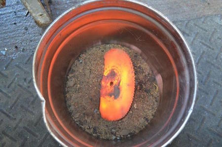

To make the saw blade workable and lessen the danger of injury while cutting it, it is important to anneal the blade. This is accomplished by first heating it to the “critical temperature” which is a red/orange color and the point at which the metal is no longer attracted to a magnet. Immediately remove the hot metal from the heat and bury it in warm sand or ashes and let it cool slowly – a few hours is best. Once cooled to the touch, the blade should be at its softest, and you could probably cut it with a hacksaw, but a 4 ½” grinder with a thin cutting wheel makes the job go very quickly!

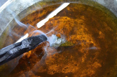

Now it’s time to harden the points. Get everything you’ll need for this step together beforehand as you have to move fairly quickly when you remove the points from the heat and immerse them in the quench. Gather your tongs or pliers, container of oil, gloves, safety glasses, fire extinguisher, and heat source. Be extremely careful with this entire process as you’re working with flammable liquids and red hot metal! Doing this outdoors, well away from flammable materials would be a good idea – again, wear safety glasses throughout this entire process!

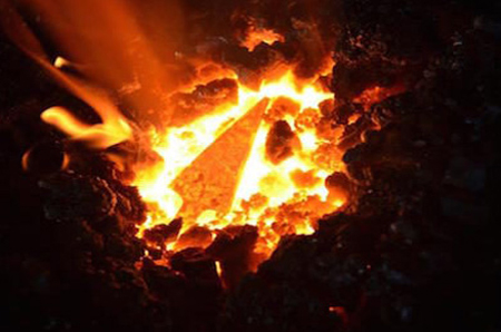

Begin by again heating the points to their critical temperature (red/orange) and immediately quench them in the oil. This will cause smoke and perhaps flames, so be careful! The metal is now hardened! You can check the hardness by running a file or hacksaw over the blade; it should just skid off and not cut into the metal. (If the blade isn’t hard, you may try re-heating and quenching in water; if it still doesn’t harden you may not have high carbon steel, or it may be an air hardened steel.) The metal is as hard as it can get, but will be brittle and could contain internal stresses. Do not try to bend or straighten it now, or even drop it – it may break. You need to temper the metal to make it useable.

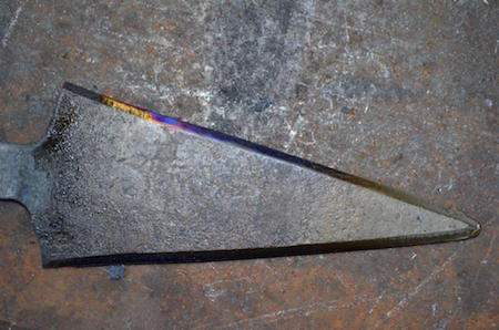

The first step is to polish the metal slightly so you’ll be able to see the “temper colors” as they run across the metal. You can do this polish with emery paper, a piece of a grinding wheel, or even a file or wire brush – you just need to be able to see the bare metal. Get your quenching oil nearby and slowly heat the back of the blade (where it attaches to the arrow shaft) with something like a small propane torch. You don’t need to heat it red hot, you’re heating to about 800 degrees, just slowly heat it until you see the temper colors of yellow, straw, blue, etc., begin to form at the edge of the heat. Carefully run the heat over the blade until the straw color “runs” to the cutting edge and tip of the broadhead, then immediately quench it. Do this process very slowly and carefully because if you overheat the metal you need to go back and re-harden it.

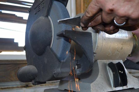

The trade points should now be hard and tempered and ready for final sharpening and use. Be careful if you sharpen them on an electric grinder, as any time the metal heats to beyond where you can see the temper colors develop, you’ve taken the hardness out of the metal.
